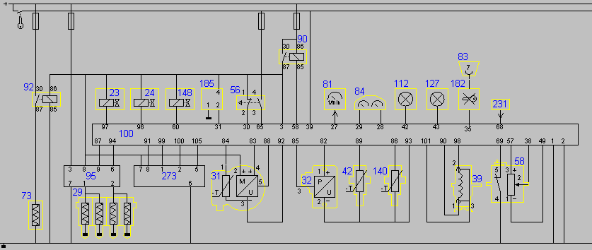

ČAU LIDI,MÁM MALINKATÝ PROBLÉM ZA VELKÉ PENÍZE,POTREBOVAL BYCH PORADIT SE ZÁVADOU NAFTOVÉHO ČERPADLA NA ASTŘE 2L.DTI 60KW.ČETL JSEM TU PODOBNÉ ZÁVADY A ZAJÍMALO BY MNE JAK JSTE TO VYŘEŠILY, NEVÍM JESTLI MÁM V HÁJI ČERPADLO ,ELEKTRONICA CVAKNE A ČERPADLO KDYŽ TO DÁM NA KANYSTR TAK NAFTU NATÁHNE ALE NAMONTOVAL JSEM NA SKOUŠKU VSTŘIK Z JINÉHO AUTA A TEN NEPROTLAČÍ. PROSTĚ MI TO NEDÁ NAFTU DO MOTORU. DÍKY ZA RADY

Čerpadlo je označeno 273
