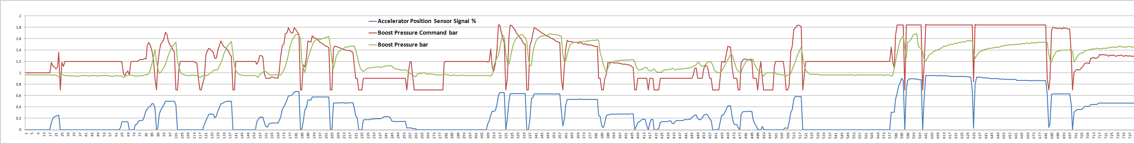

To VectraB:
In attached graph you may see dependency Boost Pressure Command from Accelerator Position Sensor Signal. But this is X20DTL engine.
V priloženom grafe je vidieť závislosť požiadavky tlaku turba od polohy pedálu plynu. Ale to je motor X20DTL.

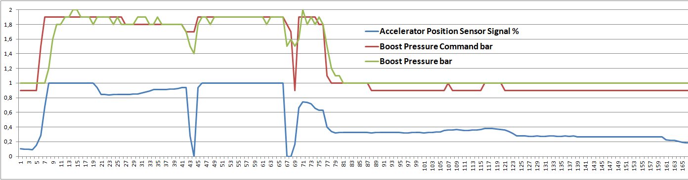

Motor 1.7DTL

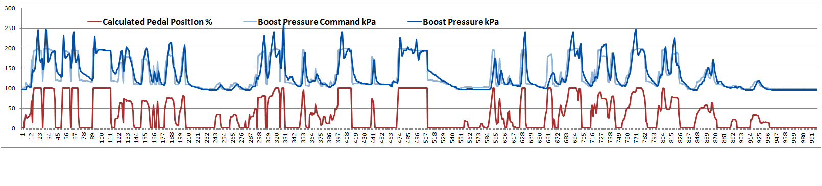

Motor Y22DTR.

But if we look only at the boost pressure signal, is it correct? Because I didn't noticed any problems with turbo boost, it starts to boost at about 1800rpm and I think if I'll change my MAF to the new one, my car would run as it should with 74kW :roll:

For test of turbo boost regulation you try full throttle on third or fourth speed gear from 1500 RPM to 4000 RPM. Send Live data and we will check it :wink:
Pre skúšku regulácie tlaku turba vyskúšaj plný plyn na tretí alebo štvrtý prevodový stupeň od 1500 do 4000 otáčok. Pošli Live data a my to skontrolujeme.
